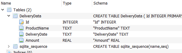

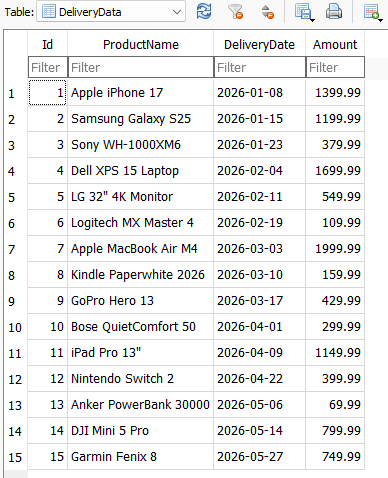

Relating Calendars to Date/Time Columns in Databases
A key feature of calendars in AIMMS is the natural mapping to date/time columns in a database. In this example, the data source is a SQLite database. Consider the following table:
../../_images/SQLiteDatabaseTable.png
with its design view:
../../_images/SQLiteDatabaseDesignView.png
